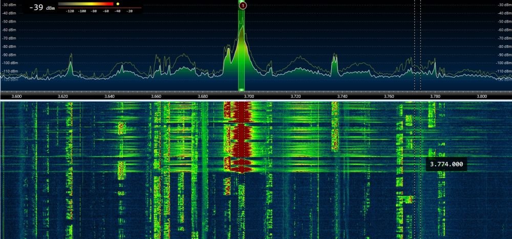

Great advice! Too bad there are only 2 types of hams, the guys who read stuff like this and the guys who complain about their PA doing strange things (and blame the PA for it) in partially unreadable transmissions because the in-shack RF is destroying their modulation. :mrgreen:
I have a guy who's here on vacation a few times each year and he always has that same old problem, to make things worse he's bringing some cheap Italian "brick" PA, really hard to not know when he's back:
Re: Checking for suspicious CMC
13dka wrote: Sun May 29, 2022 1:25 pm Great advice! Too bad there are only 2 types of hams, the guys who read stuff like this and the guys who complain about their PA doing strange things (and blame the PA for it) in partially unreadable transmissions because the in-shack RF is destroying their modulation. :mrgreen:
groan, if the PAs you're referring to are "RM Italy" or "ZetaGi" then I feel your pain, those things are just "CB" stuff adapted to work on HF, they have NO filters at all....SIGH
