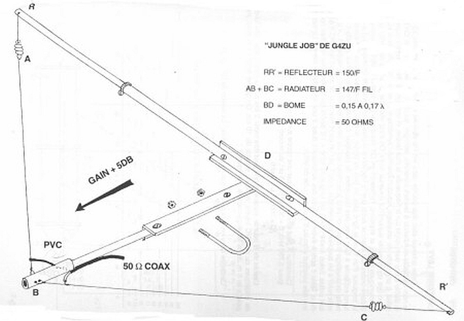

Hi there, Jock, you may try the "jungle job" from Gordon "Dick" Bird (G4ZU - SK), the antenna is really simple and can be seen at the bottom of this page (and in the image below)
basically it's a two elements Yagi antenna with the radiator element bent to form a "V" shape, while the image shows the antenna built using aluminium pipes for boom and reflector and wire for the dipole, it can be built using wood (or telescopic fishing rods) for the boom and reflector support and wire for the dipole and reflector; the gain is around 10dBi and the antenna shows a nice directional pattern with a front/back ratio about 19dB, the feedpoint impedance is in the range of 50 Ohm so it matches the standard coax, although a 1:1 balun could be used to avoid distorting the pattern due to imbalances, the image below shows what to expect from such an antenna (from a quick NEC simulation)
size is quite manageable, the calculations are shown in the first image above, the antenna can also be used for TX and the size remains manageable for antennas calculated up to the 20 meters Ham band oh and... by the way it will work fine for the 2m band :D
Forgot, as for all horizontal antennas, installation height has an effect on the pattern and the gain, a reasonable and manageable height will be 0.60 Lambda (reason explained here) which, for the FM band would be around 1.83m (6ft)
NOTE: the formulas given for lenghts will give them in meters
just to be totally clear
Frequency 98.000 MHz
Lambda (300/MHz) = 3.061 meters
Reflector (150/MHz) = 1.530 meters
Dipole (147/MHz) = 1.500 meters (each arm=0.750 meters)
Boom (0.17 lambda) = 0.520 meters
Height (0.60 lambda) = 1.836 meters (recommended, not mandatory)
HTH

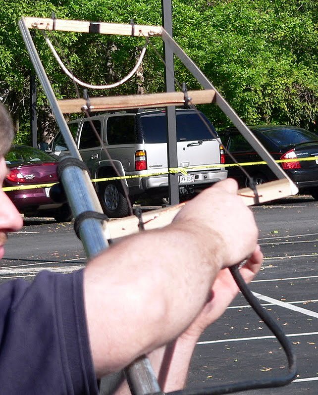

Another easy to build and quite efficient antenna is the H-DoubleBay by W4GRW, the antenna can be built for the HF or for the V/UHF bands, the original website disappeared in the internet limbo, but luckily was archived so a good copy is still available here
http://web.archive.org/web/202102160504 ... hdoublebay
the image at the front page shows the antenna built using just wires, spacers and ropes, and that's ok for use on HF bands where the antenna can have
a quite big size, but it can be easily built for VHF using just some plywood and wire and will result in a pretty manageable antenna
http://web.archive.org/web/202102230354 ... conference
http://web.archive.org/web/202102230354 ... ebayphotos
a standard "doublebay" (not a quad or octa one) for VHF could probably be built using a broomstick, some pieces of PVC pipe (horizontal spacers) and some wire, the performance will be pretty good, the NEC model shows a gain around 10.6dBi with low takeoff angle and a nice bidirectional "8" pattern, and then that antenna won a lot of VHF contests, so it may fit well for hunting faint transmitters :D
Here's an example, this one is for the 2 meters band
