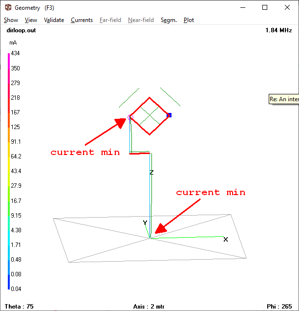

Well, an antenna indoor is subject to reflections and parasite coupling, so I think that the only test would be trying the antenna "in the clear", yet, reading what you reported, the indoor test seems promising; what else... oh yes, I just ran the NEC model of the antenna (the latest one) to check for currents, and currents on the feedline are pretty low, so maybe chokes won't be needed, also, looking at current nodes with the antenna at 3m from ground and the feedline going all the way down, the NEC model shown a node (current minimum) near the base of the vertical support, if that's correct, then placing the chokes there will have higher effect and, at the same time, would solve the "weight" issue, the image below
shows the currents distribution and magnitude, as you can see there are two usable nodes, but the first one is near the feedpoint while the second is near the feedline bottom and more convenient, also looking at the magnitude it's easy to see that the feedline shows a current of around 1.7mA while the antenna loop a current around 220mA, the only segment showing high current is the bit of feedline running horizontally below the antenna, but that shouldn't be a problem given that the real antenna has an "arc" of coax; I may simulate that if needed, but would require putting together a bunch of short segments to simulate the curve <sigh>

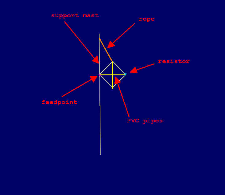

As for support, maybe it's a crazy and too complex idea, but just to play some "brain storming", check the pic below
the idea is to use some PVC pipes to form a cross, the left of the pipes cross hosts a "T" junction which is used to tie the cross to the (non conductive) vertical mast, a rope tied between the top of the cross and the upper section of the mast supports the cross, the coax runs vertically from the feedpoint (where the cross is tied to the mast) so there's no "dangling" coax
Again, probably it's too complex and/or not robust enough, not sure, it's just an idea off the top of my head

Andrew (grayhat) wrote: Tue Jul 26, 2022 9:29 am As for support, maybe it's a crazy and too complex idea, but just to play some "brain storming", check the pic below
Thanks for the effort, Andrew! But the problem isn't so much the dangling coax (which is ~1m, neither much to dangle nor much weight), it's the weight distribution on a rather flexible fiberglass pole. The antenna has more weight on one side of the horizontal boom of course, which in turn may bend the affordable portable fiberglass poles, which would be a natural companion for this antenna. The smallest of these masts would suffice for the SDL but they're pretty thin and therefore sensitive to this.

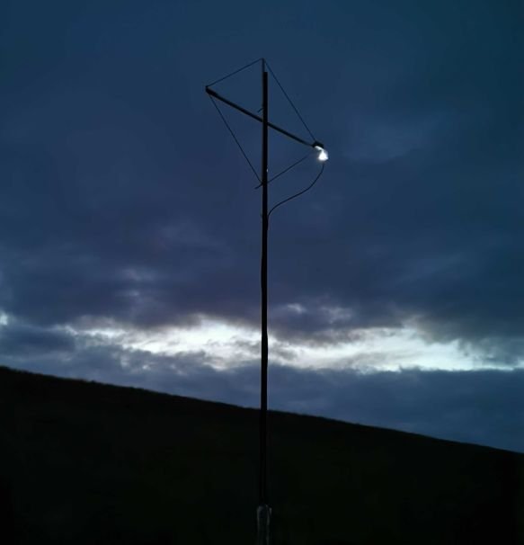

Re the changed feedline...
Fig.1: 5 out of 10 passing cars step on the brake when they spot this. Damn heathens... :mrgreen:
This evening I could observe the directionality for the first time on 20m, previously considered to be the "problem band". I heard a Japanese station and when I was just about to turn the antenna to the north an Italian station called, pretty loud. While I was turning the antenna that station dived considerably into the background and another station calling came up. (That sounds like QSB/AGC action but there was no QSB, it's all me turning the antenna, sorry for the lazy filming of the recorder):
That this antenna seems to love Japan is very likely due to the fact that I can easily turn this straight to the north and cover all northpole and greyline paths between 290° and 70° at once due to the pretty wide beam. The LoG is usually pointing ESE-WNW, with one null pointing more or less towards short path Japan. Next is a pretty much failed attempt at showing the effect on RNZ 15720 kHz. Unfortunately there is too much wind noise, which I didn't hear of course when filming the antenna rotation, but you have to admit the glowing feedpoint illumination is cool: :mrgreen:
A few minutes later the rain started, the wind picked up momentum. Next thing I now is that the antenna was down to 1.5m. The rain stopped just in the right moment for Australia VOLMET. Sorry again for filming the recording (too tired to pry the SD-card out of the Icom and find the adapter to transfer the file, convert it yada yada). First thing you (don't) hear is the station while the antenna is turned off axis, then I FFWD to the point when I have turned the antenna to the north, then after the antenna was raised to 3.5m again:
This is another demonstration that the antenna can still deliver true DX at very little height. I packed up early around 4:00am between showers, conditions were pretty down so I couldn't play with ZL signals on 40 etc. I did pick up some extra difficult TA MW DX tho - first time I tried that in summer and I could pickup Bloomberg Radio from NY on 1130kHz, not good enough to understand entire sentences or ID the station but hey, the lines on the waterfall are back!
Long story short: The antenna seems to work as expected, but only if the expectations are reasonable. :) By this I mean the directionality, its sensitivity has yet to be examined further, that the elevation angle is flat is very much supported by the results so far, more insight will come when I finally get to the dike early enough in the evening to put up two antennas.
pretty impressive, and further demonstrates how, changing the antenna orientation it's possible to attenuate or "null out" an undesired transmitting station !

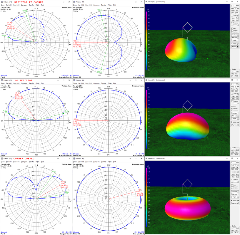

Well, as for the horizontal beam width, I'm fiddling with that in NEC and trying to find a way to make it narrower if possible, the idea at the moment is to experiment changing the size of the loop sides with the latest config and checking the effect, will post an update if I'll find some working "hack"

Forgot, the NEC predicted radiation pattern for the current design is shown in the image below
as you can see, when going up in frequency, the vertical lobe becomes narrower but at the same time, the backside "null" becomes less pronounced, this probably explains why, by turning the loop you weren't able to completely null-out that station on 20m

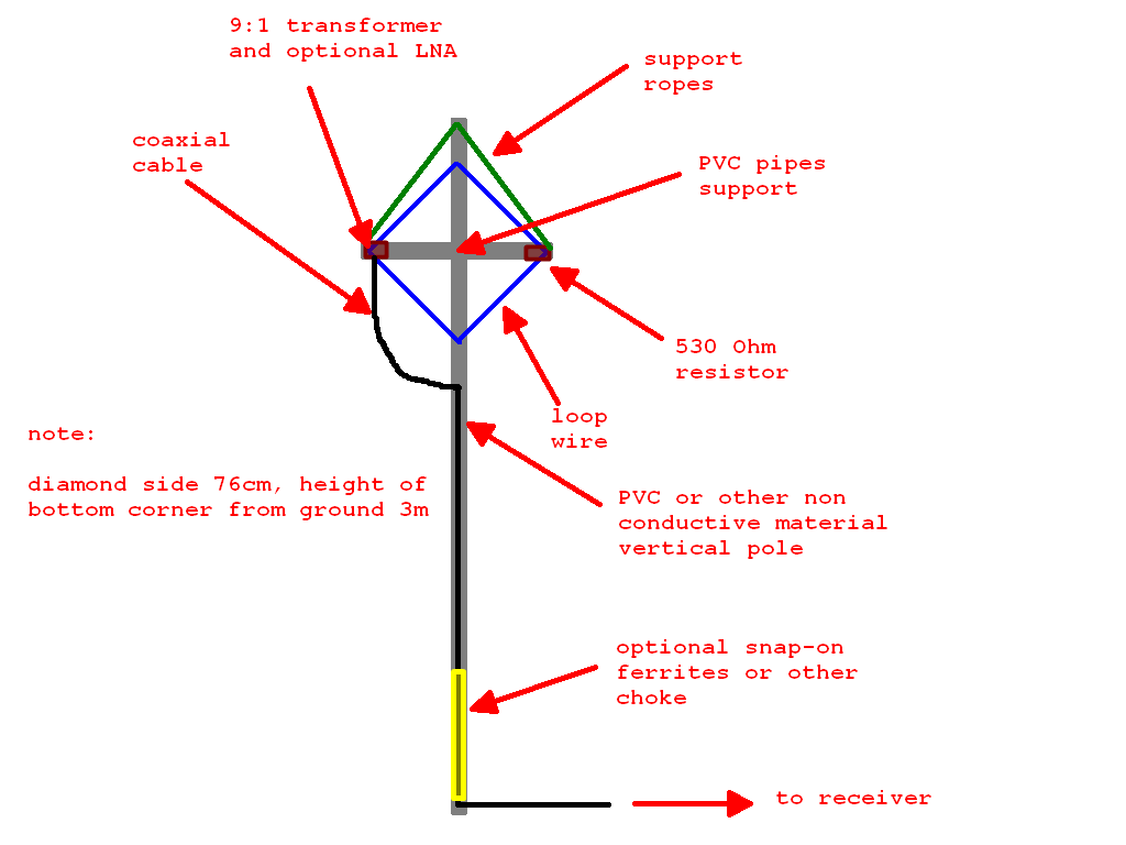

Here's another idea to "balance" the antenna structure, instead of hosting the preamp inside the same box hosting the balun, move it to the point where the coax is tied to the vertical pole, in such a case a "drop cable" will come from the feedpoint to a box hosting the preamp and, from there, the main coax will go down to the receiver, this would allow moving the weight of the preamp to the antenna support pole and possibly have a better balance; also notice where the chokes are placed in my "masterpiece" (previous post), that is near the bottom of the pole, this is because, from NEC simulation, with the bottom of the antenna at 3m from ground, there should be a current minimum at that point, and this will increase the effect of the snap-on ferrites; the only drawback in moving the preamp to the pole is that you won't have that cool "direction indicator" light anymore", oh well :)

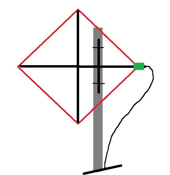

Andrew (grayhat) wrote: Wed Jul 27, 2022 7:31 am Hmm... I see, now here's an idea (no masterpiece of art :D !)
not sure it will solve the fiberglass pole issues, but at least may allow to better distribute the load thanks to the additional supporting rope; I wonder if, by using some PVC pipes inserted over the larger section of the fiberglass pole it may be possible to reduce/solve the issue
What I described earlier is this:
The antenna is mounted to the pole on its center of gravity (like Yagi beams) using another piece of plastic profile. But then again, this prevents folding the booms for transport unless this gets screwed on and off...maybe too much hassle, I like that I just have to unscrew one of the 2 screws joining the 2 booms. The actual weight imbalance with the balun box, the preamp and the coax is maybe 100-200grams since the ferrite beads are not weighing this down anymore and that little weight could be added somehow (what's a good non-metallic weight?) as a counterweight on the other side if need be. I have to order one of these small portable poles to see how that works out practically. For fixed installations this is likely a non-issue anyway.
Andrew (grayhat) wrote: Wed Jul 27, 2022 7:31 am Well, as for the horizontal beam width, I'm fiddling with that in NEC and trying to find a way to make it narrower if possible, the idea at the moment is to experiment changing the size of the loop sides with the latest config and checking the effect, will post an update if I'll find some working "hack"
Sorry for being sceptical - I'm not quite sure if that's always practical or desirable, if that's even possible at all. For example if the noticeable minimum is traded in for a narrower lobe, it will be harder to find the direction of a signal using the sharp minimum while it will be still hard to find it using the maximum and having these minimums is certainly a valuable asset (think pinpointing QRM sources by walking around, this antenna is still quite lightweight and handheld-portable). Having both at the same time might be a really tall order.
The narrower the lobe, the more need to rotate the antenna for faint off-axis signals etc. It's always a trade-off and my feeling is that for the intended general SWL purpose, the ~170° wide lobe may have the most benefits with the least amount of downsides? I imagine that making the lobe narrower will likely not come with more gain and the achievable reduction of the lobe width is possibly not that high? For hardcore MW DX the lobe can't be narrow enough of course but that antenna may not become the weapon of choice for that purpose due to the low gain down there anyway. Using a custom preamp instead of the 2 NooElec parts could change that of course, and searching for an optimum beyond the "easy to obtain off Amazon parts" restrictions may be a rewarding thing.

Andrew (grayhat) wrote: Wed Jul 27, 2022 7:31 am Forgot, the NEC predicted radiation pattern for the current design is shown in the image below
One thing the article presenting this antenna should make very clear is what to expect from this antenna, staying away from any kind of hype. That's what I meant by "the antenna works as expected if your expectations are reasonable". Most people reading that may have zero first-hand experience with beams (like yours truly) that were not made for TV reception and may be disappointed otherwise, but even if they have.... the minimum on the backside is not what a Yagi-style beam would have to begin with, but its existence doesn't mean it will make signals disappear. I want to make sure that people understand that this won't work like a flashlight, that 3 S-units difference mean nothing on an S9 station and that the null is not a null most times, even if it looks like that.

13dka wrote: Wed Jul 27, 2022 2:51 pm What I described earlier is this:
Yes, that's another possible way to arrange the loop, I just wonder if the additional complexity when it comes to deploying or dismantling the antenna, for portable use, may be worth

Andrew (grayhat) wrote: Wed Jul 27, 2022 3:32 pm the only thing I didn't try (yet :D) is flipping the loop horizontally so, in practice, turning it into a "mini rhombic" antenna, I think I'll give the idea a spin, just for curiosity 8-)
tried it, no cigar :?
oh well :D
