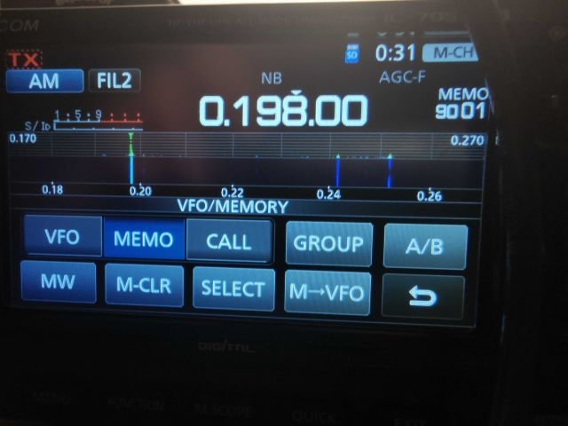

With the reduced gain MW looked even more bland than on the last attempt at the dike (with the better LNA) but browsing the band it dawned on me that what I was seeing on the waterfall was the yield of a beam turned NW, covering the remaining British stations more than anything else, and they were all there of course, including various local-ish private stations. Of course, it's still not that brilliant that it could bring in these stations during the day like my CCR2E would. Shortwave was not really something to phone home about but the IBP scans were plausible for the condix and brought the expected signals (Mt. Umum readable, KH6 not so much but WWVH was almost readble) in the morning, just as the LoG or vertical would have I guess.

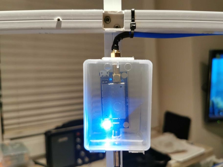

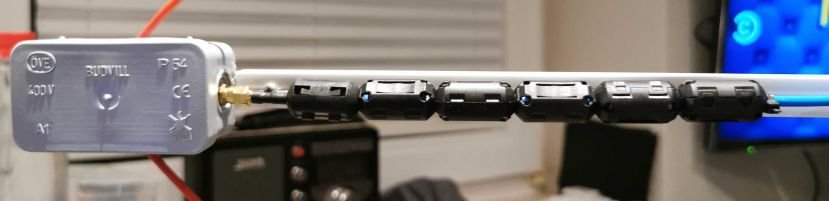

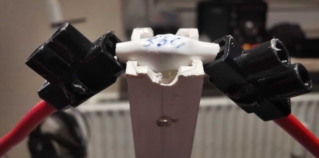

Today I used a 50cm piece of rigid RG-402 I sourced to put the choke right behind the balun. I'm guessing that the number of ferrites is half of what's needed to be effective but the antenna is already not very balanced (edit: weight-balanced that is) anymore. Also to show why these plastic cable duct profiles are a good choice to make the support structure :
Here's the new LNA position:
Resistor pack detail:

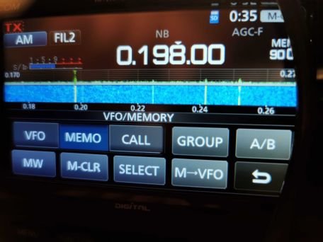

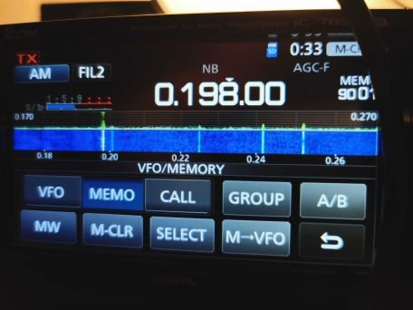

Not sure/no idea if that choke made any difference but here's RAI Milano 900kHz when I rotate the antenna indoors (the pronounced null is exactly where it should be!):

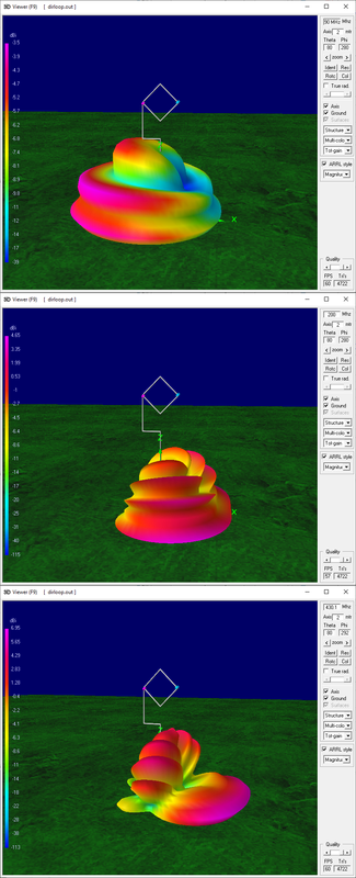

Ok, had the time to run further NEC simulations, and the way the coax is routed does indeed influence the loop pattern, here's an example
as you can see, routing the coax along the horizontal arm and then down the vertical support or routing it "outside" the loop, makes quite a difference, in the first case, the cardioid pattern is "deformed" so, while there's still backside attenuation, it's lower, plus the upper angle of the beam is vertical, so making the loop sensitive to NVIS signals, changing the setup and routing the coax "outside" the loop, instead, shows a well formed cardioid pattern with a deep null and an upper vertical angle around 20° from vertical, so allowing to better attenuate NVIS signals
Now, I understand that routing the coax that way would be a mechanical challenge, but I think that using a run of thinner coax hanging from the feedpoint at the loop corner, down to a point of the vertical support below the loop bottom corner and then using fatter coax from there to the receiver may be a viable solution; also notice that routing the coax this way will minimize parasitic currents on the coax so, willing to add some chokes, we'd just need them on the "fatter" coax going down the vertical support
As a note, even if the above pic shows the simulation on 40m, I ran the model at different frequencies and ALL of them showed a consistent cardioid pattern with a deep backside null and a lower vertical angle, so I think that the somewhat strange receiving behavior you observed may have been due to the coax interfering (and modifying) the loop pattern
If you want to try running the simulation yourself, here's the model

as it is, the coax is routed "outside" the loop, willing to try the "inside" routing, just uncomment wires (GW tags) #10 and #11 and comment out #20, #21 and #22; what else... oh, yes, with that "outside" coax routing the loop remains directional even up at 90MHz and while the horizontal lobe is wider, the backside "null", even if not as marked as down on HF, is still there, so interference from FM stations will be attenuated and this, in turn, will help receivers with a poor front-end filter
Let me know if you'll need further infos or details
[edit]
forgot, look at the F/B figure of the loop when the coax is routed outside, the NEC simulation predicts 29.6dB of F/B ratio on 40m (38.2dB on 80m and 21.9 on 20m), which means that it could be possible to "cancel" even some blowtorch station just by turning the null toward it !

Further tests on the SDL show that, with the latest "coax routing" the directional pattern progressively changes, at around 120 MHz the antenna develops side lobes, while going up in frequency the beam is directed toward the resistor direction
Re: The small SWL beam (1...30 MHz)
Wow, that does seem to make a difference! BTW, that's how I initially intended to arrange the feedline, that's why I was asking "what horizontal stretch?" when we discussed this first. :D But I wasn't fond of some coax permanently dangling around in the wind either, adding the pull of the coax to the weight and longer arm of balun and preamp, causing some really bad weight distribution causing the fiberglass pole tending to bow etc.

Edit: Playing with the new .nec file and comparing that to the old one it looks like this even has 3dB more gain on 17m and maybe more above (Edit again: 28.1 MHz loses a bit). The pattern really looks better and it retains more of a minimum (to avoid the term "null") on the upper bands (which I think is where this design is likely to shine most, also considering the upcoming solar maximum!).

13dka wrote: Mon Jul 25, 2022 3:34 pm Wow, that does seem to make a difference! BTW, that's how I initially intended to arrange the feedline, that's why I was asking "what horizontal stretch?" when we discussed this first. :D But I wasn't fond of some coax permanently dangling around in the wind either, adding the pull of the coax to the weight and longer arm of balun and preamp, causing some really bad weight distribution causing the fiberglass pole tending to bow etc.
Guilty Your Honor !! The idea of routing the cable through the center of the loop was mine and mainly related to an attempt to avoid loading the support structure too much, but according to NEC that isn't a good idea <sigh>
One easy way to address that would be finding the center of gravity of the entire antenna plus 1m of coax hanging off the balun/preamp, then screwing an additional vertical mounting support to the horizontal boom at that place. That will also shorten the length of coax required to reach the pole a bit and avoiding a lot of ferrite beads tied to one side of the boom would certainly help too.
another way may be using a short run of thinner coax describing a curve (in NEC i modeled that with corner just for simplicity) from the feedpoint down to the vertical support and from there start with "fat" coax; notice that judging from currents shown in NEC simulation, with such a routing the chokes may just be fitted on the "fat" coax running down the support and additional load shouldn't be a problem there

The only thing that looks like a worthwhile variation (to me) is opening the loop circuit (R=infinity) to create a nice round and flat omnidirectional donut shaped pattern around the antenna, with much increased gain. This could be done by integrating a small SPDT into the support structure or small box, so the resistor can be switched in and out without much wiring hassle and disturbing the shape. A third switch position connecting the loop wire ends directly would change the omni pattern to a somewhat more oblong shape including the near-vertical incidence signals.
removing the resistor from the circuit, the result will be an antenna with a pattern similar to KK5JY SRL http://www.kk5jy.net/rx-loop while opening the loop will result in a donut pattern similar to the one from a vertical antenna, the idea isn't bad at all and would give 3 antennas in one !
Oh well, time to get the antenna out of the trunk to change the feedline position. Looks like I didn't buy these 90° SMA bits in vain! :)
Well, sounds like we found a way to use those 90° adapters :D as for changing the feedline routing, if you'll have a chance, it would be interesting trying the modified loop at home, while walls will cause reflections and the pattern may be distorted, it will at least tell if the backside minimum is where we expect it to be
Edit: Playing with the new .nec file and comparing that to the old one it looks like this even has 3dB more gain on 17m and maybe more above. The pattern really looks better and it retains more of a minimum (to avoid the term "null") on the upper bands (which I think is where this design is likely to shine most, also considering the upcoming solar maximum!).
yes, gain seems to be a bit higher, and front-to-back much better, as for bands, it may be possible to optimize the antenna for lower frequencies by increasing the size and, probably, adjusting the height of the antenna from ground, just tried raising the side to 2m (ok, probably too much) and raising the antenna to 5m and obtained a "gain" of -48dB on the 160m band, while the 76cm side version has a "gain" of -64dB down there and -42dB on 40 meters, but before going for such a mod, I think exploring the performances with the modified feedline and doing that even down in frequency could be useful to decide "where to go next"; also, regarding gain, an alternative may be trying a higher gain preamp for the lower bands, there are some 30dB or more LNAs around, but then I'm not sure they may be worth
