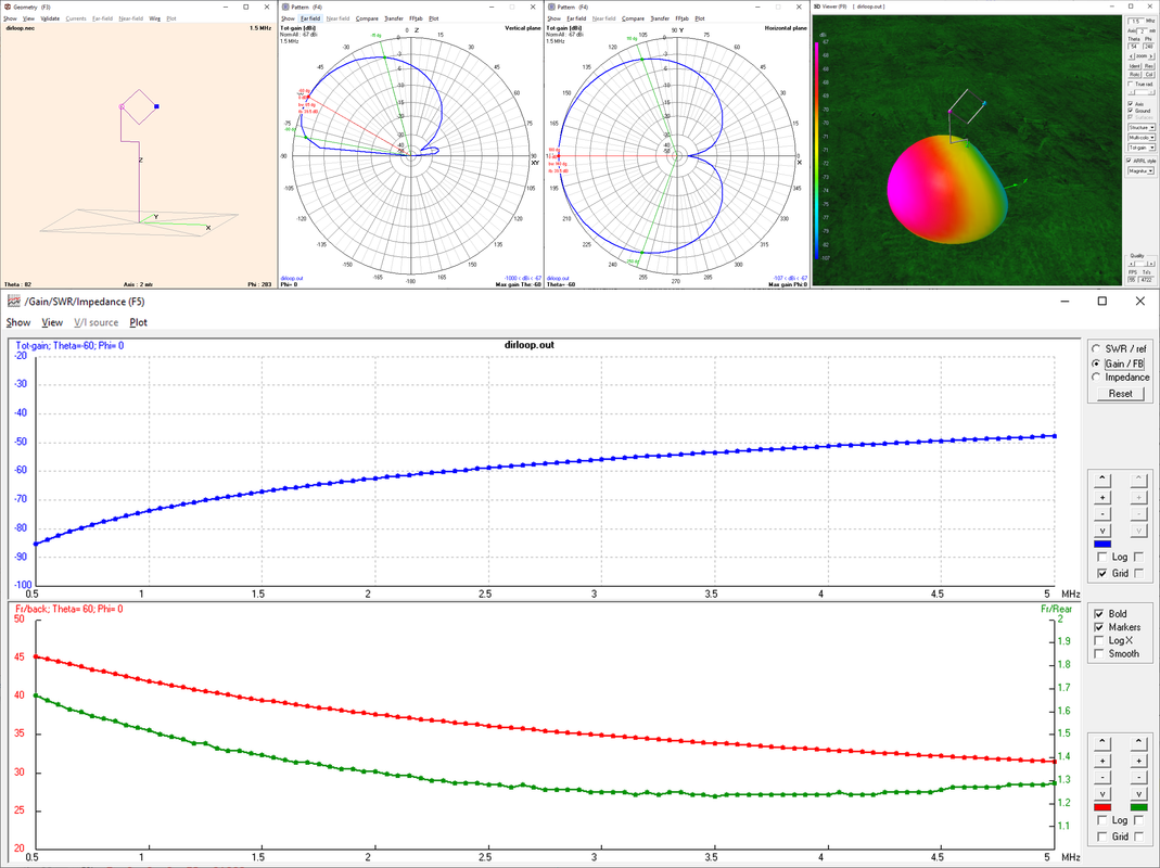

As for MW and lower frequencies; let's start from the NEC model of the SDL, start a sweep, set the range to 0.5 to 30.5 MHz and the step to 0.2, run the sweep and at end look at the gain curve
The point is that going down in frequency the SDL gain drops with a quite steep curve, now the first workaround which came to my mind was a higher gain preamp, but I'm not convinced it may solve the problem... the second idea I had is adding an inductor in series with the resistor , so I'll need to run some NEC simulations and if the inductor idea will show promise, I'll try finding the optimal positioning and value for the inductor

Andrew (grayhat) wrote: Sat Jul 30, 2022 12:51 pm The point is that going down in frequency the SDL gain drops with a quite steep curve, now the first workaround which came to my mind was a higher gain preamp, but I'm not convinced it may solve the problem
The practical behavior reflects the simulation to the i-dot in this regards and I'm entirely sure that more gain will not help, simple telling from the response to different gain from the LANA HF (remember, I can switch between full and less gain via Vss) not doing anything except shifting the same SNR (or lack thereof) to a different signal level.

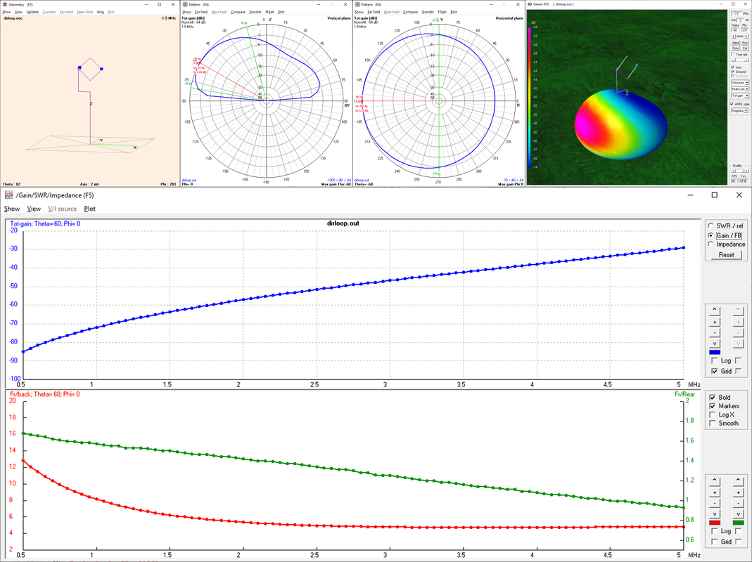

Ok, gave a spin to the inductor idea, after fiddling with values and positioning I came to the design in the following NEC model

in the model the inductor is commented, so the antenna is the "standard" one, willing to insert it, just uncomment the "LD 0 wind..." line and reload the model, the inductor value is 900uH, the result is below, this first image shows the "standard" antenna pattern at 1.5 MHz and the gain curve between 0.5 and 5 MHz
and that's what we already saw, adding a 900uH inductor right "above" the feedpoint, will change the antenna pattern and gain as shown in the image below
as you can see, there's a little bit more gain, but the pattern is heavily changed and while retaining a low angle and good F/B the "null" is almost gone, also, if we then look at the impedance matching we'll see that it's totally "off" since, adding the inductor, the reactance skyrockets, now, while the gain is SLIGHTLY increased, I'm not sure that adding an inductance may offer advantages; first of all the gain boost is minimal, next, one will need to add a switch to bypass the inductance, otherwise the pattern at higher frequencies will be totally changed
Bottom line, not a good idea imHo, but I think that all in all, we may still be happy with the performances the SDL offers on the SW bands and, partially, on the MW too

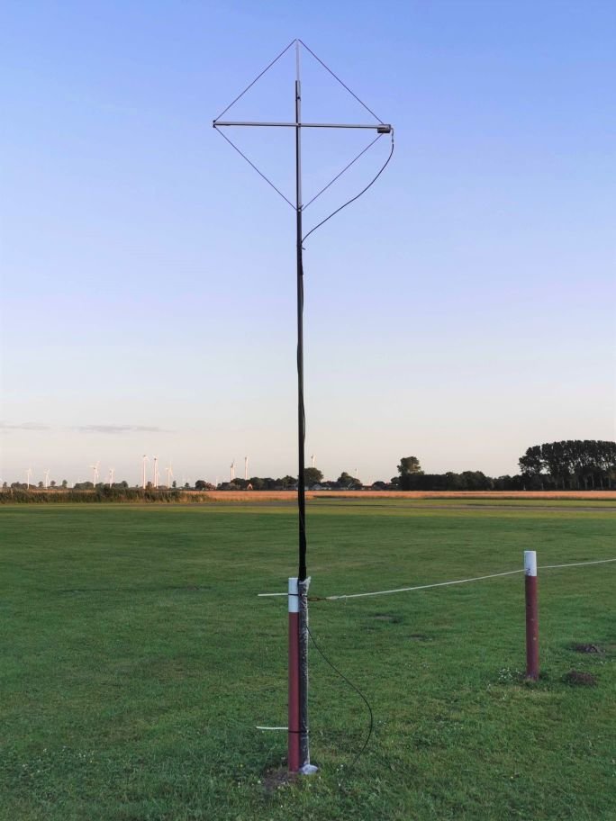

Edit: Here's another picture showing how the drawing below looks in RL:

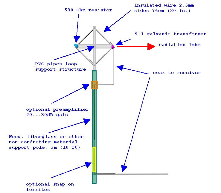

For the ones willing to try a build, here's the overall view of the SDL setup
the easiest way to build it will be using off-the-shelf components, for example, the 9:1 can be the NooElec one, while the preamp may either be from NooElec or any other commercial preamp covering the 0.5...30MHz range, the remaining components, with the exception of the snap-on ferrites and coaxial cable, may be found at any local home improvement stores (or the like)
