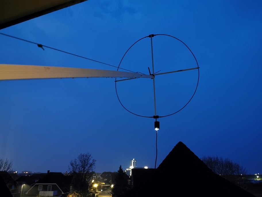

Like that? :)
(That's a YouLoop with a LANA-HF, temporarily mounted on a boom outside for a test. That's all plastic cable duct profiles off the local DIY store, very easy to cut and held together with small screws and zip ties)

Well, yes, that may work, but I was thinking at a vertical support with an horizontal bar nailed/screwed and the wire running around in a diamond loop shape
