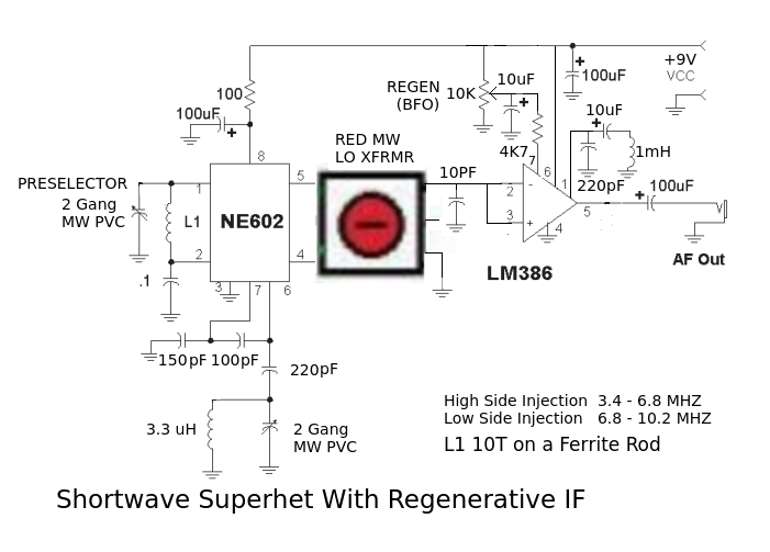

And here's another interesting circuit
https://antiqueradios.com/forums/viewtopic.php?t=373629
it's a superhet based on the classic NE602, but with a difference, the LO is a regen stage based on the LM386 (yes, not kidding)
SW Superhet with Regen IF.png (83.03 KiB) Viewed 89848 times
that "hack" allows to improve the performance of the receiver and at the same time, allows it to receive SSB signals, not bad imHo

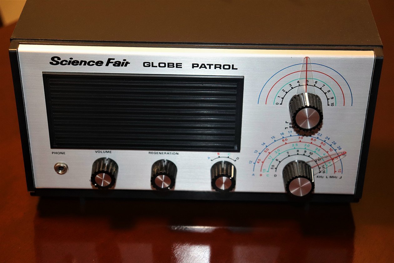

My first Regen Rig was a Radio Shack Globe Patrol kit that I built back in 1977. It was an anemic little radio, but I was still able to pull in Radio Nederland, Deutche Welle, the VOA, HCJB among others. I regretted getting rid of it when I enlisted in the USAF, but a few years ago I paid through the nose to get another one for the nostalgia. After I get my loop antenna hooked up this spring I may hook it up just to play around like in the old days.
