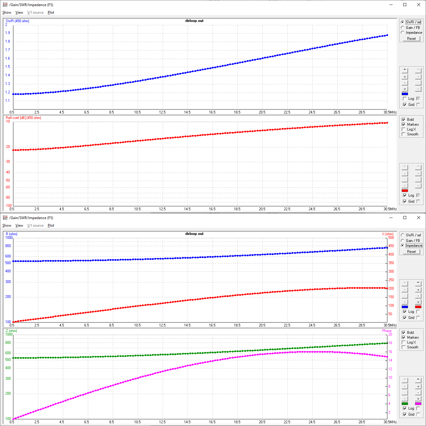

just in case, the antenna feedpoint impedance varies between 531+j4.86 at 0.5MHz and 759+j205 at 30MHz so the impedance value after the 9:1 transformation will fit pretty well for either 50 or 75 Ohm coax
for the sake of precision here are the SDL curves related to SWR and impedance over the 0.5 to 30MHz range
