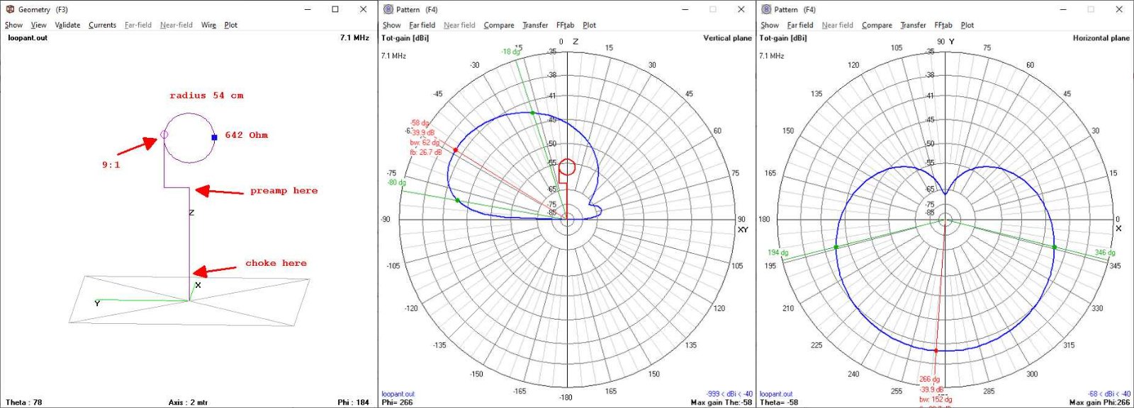

Re: The SULA antenna
Late to the party :D
Ok, here we go, I quickly built a NEC model for a round loop which should be pretty similar to your octagonal, the results of the simulation are below, notice that to recover the cardioid I had to change the resistor value to (around) 642 Ohm, also notice that the horizontal pattern is skewed because I made a little mistake in the model, but that doesn't change the pattern, as for the preamp, I inserted some infos about where to put it, also, the choke at bottom is a W2DU (Maxwell) type, that is a bunch of snapon ferrites over the coax, the bottom position is the best one looking at the currents distribution in the model
HTH
P.S. right click the image and select "open in new tab" to see it full size
rayb
Post by rayb »
Thanks for taking the time to model this configuration Andrew.
I did notice yesterday after a few actual field tests, that the resulting pattern seemed to have a null that wasn't all that deep. The noise level didn't decrease much at the null. Perhaps your results from the modeling are pointing this out. I'll try again by raising the resistance from the 530 to approximately 640-650 ohms or so, then see what the real world pattern looks like in the field. I'll also have to look into some sort of choking the coax as you mention.
rayb
the sula size, resistor and height have been optimized for the "diamond" shape, so changing shape or size will require remodeling and optimizing the antenna, that said, yes, try raising the resistor value and also lay the coax so that the section coming down from feedpoint is long about 1 full "diameter" before curving toward the support pole, as for the resistor 640 Ohm should fit your config
