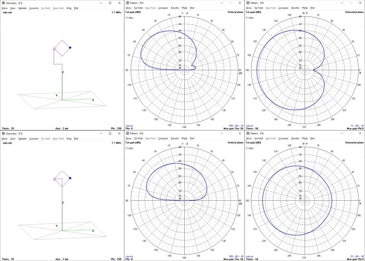

Re: The SULA antenna
just a short note about how to route the coax feeding the SULA; the image below shows the effect of routing the coax outside the SULA or inside it (through the center), as you can easily see, routing the coax toward the center (second image from top) heavily changes the pattern, the backside "null" disappears and the vertical lobe raises, so even if having a "dangling" piece of coax isn't visually nice, it MUST be routed that way if one wants to obtain the real SULA performance
- Attachments
- sula_coax_routing.jpg (185.44 KiB) Viewed 107834 times

Ok, I'm going to be "shooting from the hip" here, but I'd like to make a comment/suggestion on the previous post to mine by Andrew. He points out that the Sula's nice cardioid pattern is degraded when one attempts to make the antenna "visually nice" by routing the coax as pictured in the lower pictorial.
I thought about that for awhile and came up with an idea/modification I'd like to suggest to someone who can either model same in software, or actually incorporate the idea into their Sula.
My idea is to still use the "visually nice" routing as pictured, but instead of connecting coax to the feedpoint at the corner, connect a twisted pair of wires to the low impedance output of the 9:1 balun. Run the twisted pair, as shown in the lower diagram of Andrew's attachment. The twisted pair will terminate in a watertight enclosure, perhaps a foot below the lower corner of the Sula.

Imho, the twisted-balanced pair should allow the "visually nice" configuration to work without disturbing the desired pattern of this fine antenna. Again, I'm shooting from the hip here and just "theorizing" what should work to achieve the best of both worlds, so to speak.
What say ye? Is the idea worth someone modeling it in software or actually trying the mod out on their Sula?
