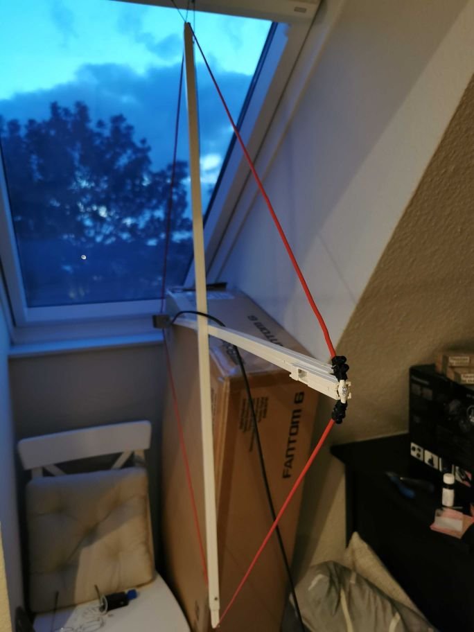

Making slow progress:
(Detachable wire guide end bits, to tense the wire and make sure everything is symmetrical)
Edit: For stability and size considerations, I'll be using 4x2.2kOhms and 1x 22kOhms parallel = 536 Ohms

OK, that took a bit longer than expected. :)
Of course I can't really say anything about the function yet from trying if I get signal at all, and indoors 6-7m AGL... but so far...
- The passive output of the antenna seems to reflect what I saw on the 4NEC2 plots - it's really weak on MW, maybe a bit less output than the YouLoop on 80 but (guess) above 10 MHz it may be increasingly and considerably better than the YouLoop.
- It is already doing what it says on the tin in that is has one relatively pronounced and narrow null. I didn't play with it that much yet of course and tried only some hams on 80, I know where those fellas are (all S of here) but there was a station I didn't know and the null said clearly "East of me", turning the antenna 180° towards Berlin increased the SNR a lot and I noticed his accent, confirming what the antenna suggested.

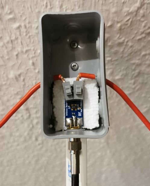

Then I heard a noise and this happened:
It's still working but I'll order a new one now. I usually simply tie a knot into the cable as relief but that doesn't work with 2.5mm wire and there's a bit much tension on the wire. Oh well... shit happens. :) I hope the weather allows for a first dikeside test tomorrow.

well, given signal reflections inside and all factors, the nulling seems promising; as for the balun... SIGH, but then it's a lesson I learned myself as well, ALWAYS use terminal blocks (if not using nuts and bolts) since they'll get the strain and not the balun, also, to lock the wires, a pair if nylon cable tiers, optionally with plastic "washers" will just fit

Funny enough, I had small zip ties around the wires but then I noticed that I need to remove more insulation (the wire was slipping out of the terminal) so I had to cut them off and didn't replace them yet. The baluns have gone up in price, I ordered the v2 version (which comes with the green connector terminal set), that's 25 bucks now (the old one is 6€ (+50% or so) more now).

The antenna seems to be a bit cross-eyed up here in my den in that the null and the peak are not exactly reciprocal - e.g. the null for RAI 900kHz seems to be in the SW but the peak (which is interestingly noticeable and not as wide as expected) is straight south. But the antenna is surrounded by metal foil, metalized windows and metal structures so that could be it. I'm curious what the patterns will be in free space.

well
https://www.amazon.com/NooElec-Balun-On ... B00R09WHT6
and then, I have some v2, they work a bit better than v1, the other option is to pick a binocular core and wind the balun
as for the v2, check the download section here
https://www.nooelec.com/store/balun-one ... bones.html

as for pattern, walls and metal can/will cause reflections, so it will be better checking the pattern on open field, as for FM judging from NEC model, the antenna shows two sidelobes there and has gain, so an FM bandstop between the balun and the preamp may be needed if the preamp is overloaded; getting back to pattern, it may also be distorted by coax, adding some chokes and/or trying to route it a different way may help
