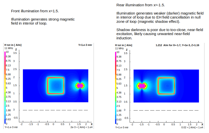

Good point. The reason I used 3 fixed dipoles was to have a completely unchanging geometry for the entire test environment, where I only moved the excitation source from one location to another. The goal was to avoid changes in geometry, which might slightly change the tuning of the outer loop, and disturb the null.
But I just now ran another simulation with only (a) one loop (the outer loop of the CTL) which is resistively loaded, high-impedance with additional loading inductance, and capacitively resonated, and (b) one excitation dipole that is moved from x=0 to x=100 to x=-100. The advantage of this scheme is that there is only one excitation dipole (10 cm long) so there are no effects of other distantly-located but inactive dipoles. The disadvantage of this scheme is that the loop's null is optimized when the excitation dipole is located at x=0, inside the loop, but then in the shadow tests (with front illumination and rear illumination), that same dipole is moved from its original x=0 location to the new x=100 or x=-100 location. By removing the dipole from the center of the loop, we may have detuned the loop away from its optimal null condition.
This could all be fixed if we could excite the loop directly when optimizing the F/B ratio. I noticed with interest that the SULA model does this, by placing the excitation source directly opposite of the resistive load. Unfortunately, in the CTL outer loop, that location (directly opposite of the resistive load) is the exact location of the resonating capacitor, and I could never get a proper cardioid pattern with the excitation source located at the capacitor. So I had to use a workaround of using a separate excitation element, which is the small (10 cm long) vertical dipole initially positioned at x=0. The reason I chose a 10 cm-long vertical dipole is that this small geometry should hopefully have little influence on the loop tuning, so that even after it is removed (for the excitation tests at x=100 and x=-100), the loop null should hopefully still be preserved.
Anyway, the result is that even with only one excitation dipole present -- with no additional inactive dipoles present to possibly alter the results -- the magnetic shadow can still be observed.
Below are the results of the front- and rear-illumination tests, with the excitation dipole (10 cm long) positioned at x=100 (front) and x=-100 (rear). No other vertical dipoles are present in the test geometry to eliminate effects of unwanted geometry. The distance between the loop and the excitation source is far enough that the excitation source lies in the far field region of the loop; with the test at 11 MHz, one wavelength is about 27 meters, so the excitation source is several wavelengths away from the loop. The magnetic shadow is still visible, proving that the shadow effect is created solely by the inner loop.
I ran another test with the excitation dipole much closer to the loop, in the near-field zone. The shadow is still visible, but weaker. I suspect this is because the near-field excitation causes unwanted reactive near-field effects like local induction. There may also be some detuning effects.

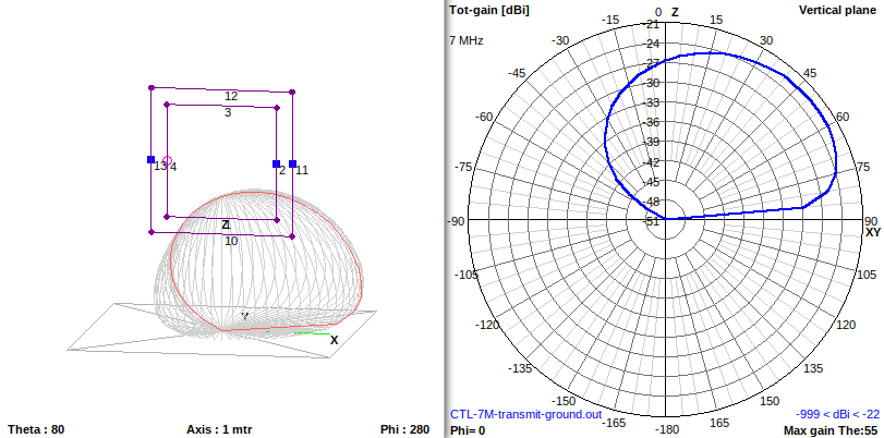

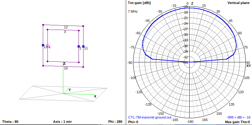

Did a quick 7 MHz simulation of a CTL over real-ground. Maximum gain is about -22.4 dBi.
The outer loop is loaded with 70 ohms of loss resistance to achieve the unidirectional effect.
The outer loop is also loaded with 20 uH of lumped inductance to achieve the high-impedance necessary for E-field sensitivity.
Assuming a Q of 100 for the 20 uH loading coil, at 7 MHz the coil loss resistance is about 9 ohms.
So in addition to the coil loss resistance of 9 ohms, we need to add about 61 ohms of additional load resistance to the outer loop to achieve the required 70 ohms of loss resistance for the unidirectional effect.
The loss resistance of the outer loop is realistic and feasible to construct in practice, because the loop conductor and the ESR of the capacitor will add some milliohms, but these are small in relation to the total required loss resistance of 70 ohms.
The outer high-impedance loop is resonated at 7 MHz with only 12 pF, so it will be sensitive to the stray capacitance of its surroundings.
The inner loop is resonated with 99 pF and will be less sensitive to stray capacitance.
The above simulation is the best case scenario, assuming that the inner loop is a perfectly lossless conductor and that the inner loop's capacitor is lossless. As a rough guess, I tried adding 1 ohm (1000 milliohms) of added resistance to the inner loop to account for conductor loss and capacitor loss. The effect on the final radiation is very small -- less than 1 dB. The effect of the added 1 ohm resistance is small because larger losses are caused by the large loss resistance of the outer loop being coupled into the inner loop.
In conclusion, a transmitting CTL is not totally out of the question, but it loses efficiency. Here's the same loop simulation, but with the outer loop detuned so that it almost does not affect the inner loop. The radiation increases.

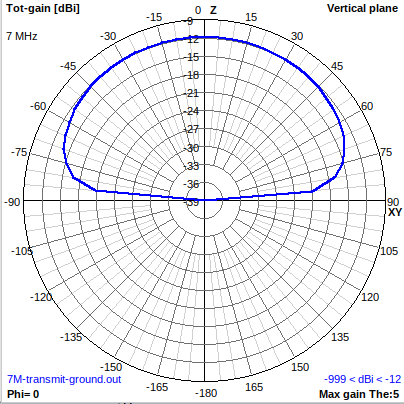

As a more realistic simulation of a "normal" small transmitting loop, I deleted the outer loop completely, leaving only the 1m x 1m inner loop. I configured conductor loss to be that of copper conductors with 10 cm diameter, and added 0.5 ohms of additional loss for the capacitor ESR. Here is the result.
So with a normal 1 m x 1 m loop constructed with best practices, we might get -12 dBi at high angles and -15 dBi at low angles -- even better if we can get the capacitor ESR below 500 milliohms, which is probably possible with a good vacuum-variable capacitor. Compare this with the poor performance of the CTL, where maximum gain is only about -22.4 dBi in the best possible case with lossless conductors.
I would guess it makes more sense to transmit more total energy in all directions, instead of trying to transmit less energy in a more focused and restricted range of directions. So I don't think the CTL concept makes sense for transmitting, unless for some reason you need to reduce your radiation in one particular direction.

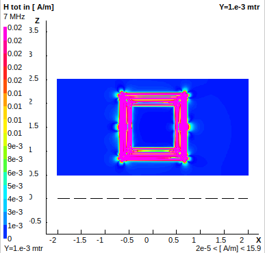

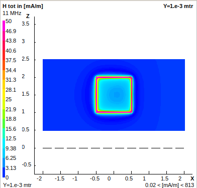

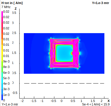

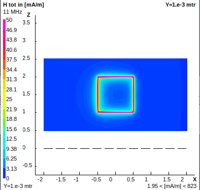

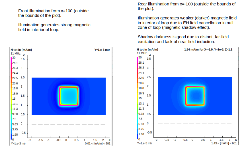

My previous magnetic shadow simulations were done with one loop only (the outer CTL loop) to show that the outer loop, by itself, can create a magnetic shadow. But the shadow is not so dark in this case.
I found out that when I use the two-loop CTL model (with both the outer high-Z loop and the inner low-Z loop), the generated shadow in the interior of the loop is much darker, indicating a much better rejection of signals from the null direction.
Here is the illumination of the shadow region from the front (x=100). The shadow region is bright, because it is illuminated from the non-null side of the antenna.
Here is the illumination of the shadow region from the rear (x=-100). The shadow region is very dark, because the illumination from the null side of the antenna is canceled or "blocked" by the field cancellation of the outer loop, thus creating the dark region, the magnetic shadow.
We need to be careful interpreting these results. The generated shadow from the dual-loops is much darker than the single-loop shadow, but that does not necessarily mean that the single loop cannot generate an equivalently dark shadow. It may be possible that the single loop, if appropriately adjusted, can also generate an equivalently dark shadow. I don't know.
The 4nec2 file used to create the above images is included below. It includes instructions for how to run the simulation to see the shadow region.
