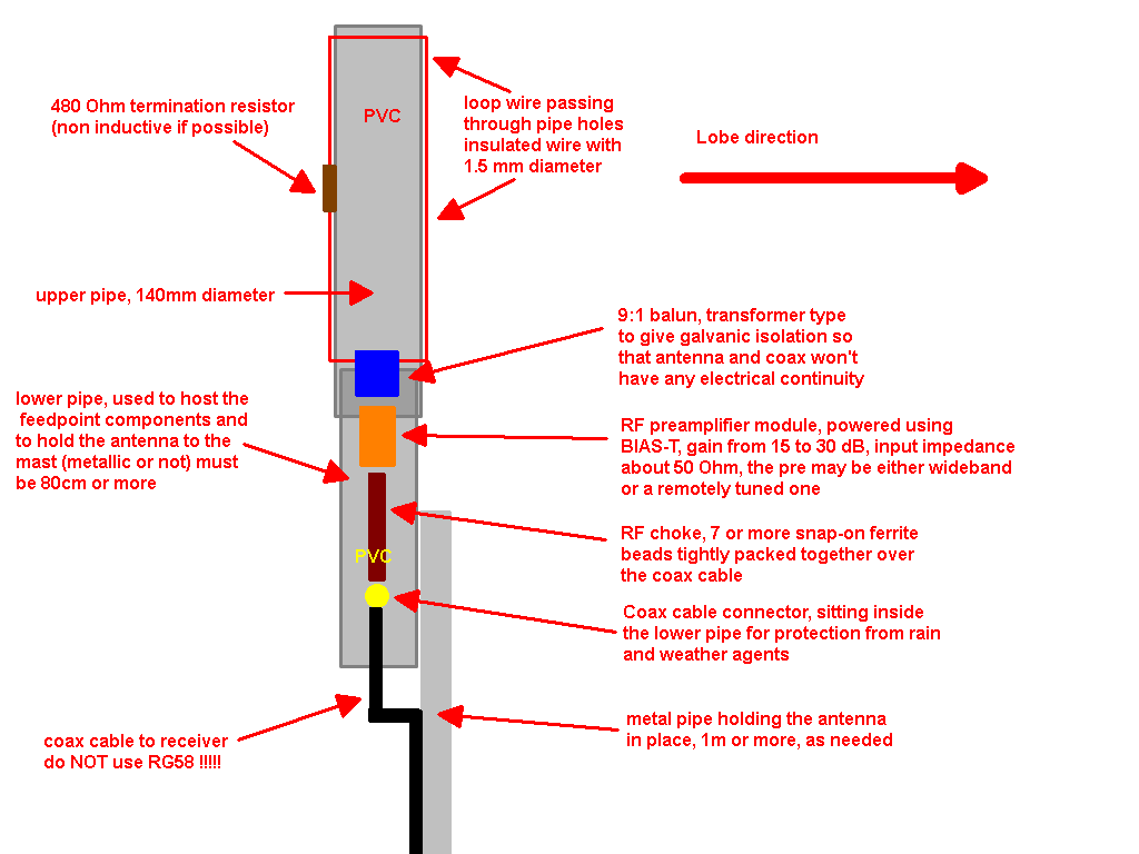

and since we're at it... I "squeezed" the SULA :D
The idea was to find a more portable antenna, and after some fiddling I came out with this design
https://postimg.cc/56N9FqM4
the loop is made of 1.5mm insulated wire and the whole antenna could be built using a 140mm (OD) PVC pipe, by drilling four holes at the sides of the pipe it's possible to run the wire through the top holes and then run down on the external of the pipe to the bottom holes, the balun, choke and preamp may then sit inside the bottom part of the pipe (if desided the resistor may be placed inside the pipe as well) protected from rain, the top of the pipe is sealed with a cap and the same goes for the holes used to pass the loop wire
The antenna shows a cardioid pattern over the whole HF range and the pattern remains the same even if the antenna is installed at 1m from ground, gain is lower than the one offered by the SULA but still acceptable, at least on the HF bands, the advantage is that the antenna is very compact and easy to carry around; to install it one may use a piece of PVC pipe or fiberglass rod to hold the antenna to a metal pole, since we don't want any metal near the loop. The SWR curve is almost flat over the whole HF band (and beyond), the 9:1, preamp and choke may be the same used for the SULA

Egil, notice that the BalUn is the same used with the SULA, and may either be bought (e.g. the NooElec 9:1 v2) or built (same as the one used here), the same goes for the choke, which may just be a string of 7 or more snap-on ferrites placed over the coax right after the preamp to form a so-called "Maxwell" or W2DU choke; as for the latter (the preamp), the nice thing is that, as for the SULA, this antenna offers an almost constant impedance match to 50 Ohm, so ANY preamp will fit, no need to use special designs used for loop antennas, ANY preamp will fit, although a gain from 15dB (or -better- more) is recommended
Re: Another directional RX loop
Here's a general idea to build the antenna, notice that the resistor may be placed inside the upper pipe, by drilling two holes, also, the two pipes are both PVC ones, the top one is sealed at top with a cap and all holes used to pass through the wire are sealed with good sealant, the 9:1, preamp and choke are all hosted inside the bottom PVC pipe to keep them protected from rain and weather, the inner bottom of the lower pipe may be closed by a disc hosting a panel connector for the feeding coax
the wire loop has 2m total lenght, 140mm on the short sides, the remainder on the long sides; measures aren't critical, one may use 3 to 6 meters of wire and the antenna will still work

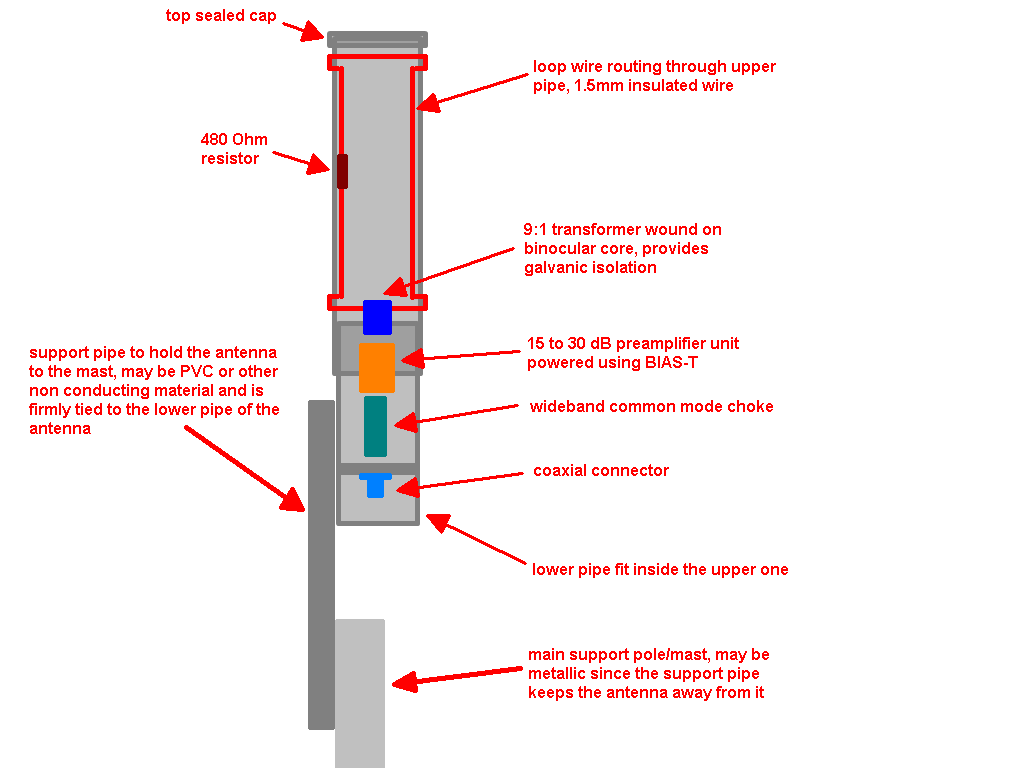

here's a better setup for the antenna; notice that the choke MUST be installed otherwise the cable could (would) become part of the antenna and totally screw the cardioid pattern; in this setup most of the wire runs inside the upper pipe so it's protected from UV and weather, same goes for the 9:1, preamp, choke and coax connector which are encased in the lower pipe
using two pipes for the antenna will also ease assembling the whole thing, and once the top cap, the wire holes, the junction and the bottom disc hosting the coax connector will be properly sealed the antenna will resist to weather w/o problems
Now, it remains to build and test it, if all goes well I'm planning to put together a raw model using a broomstick and some junkbox stuff and test if it works as the NEC simulation says, if so I may then go on and build it as for the above drawing

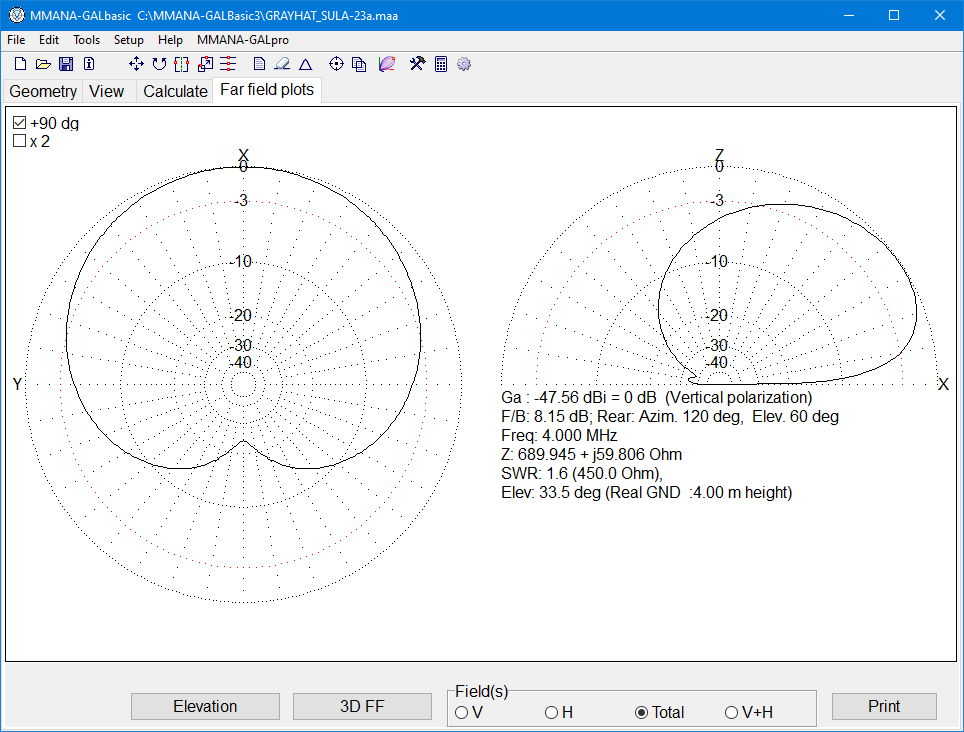

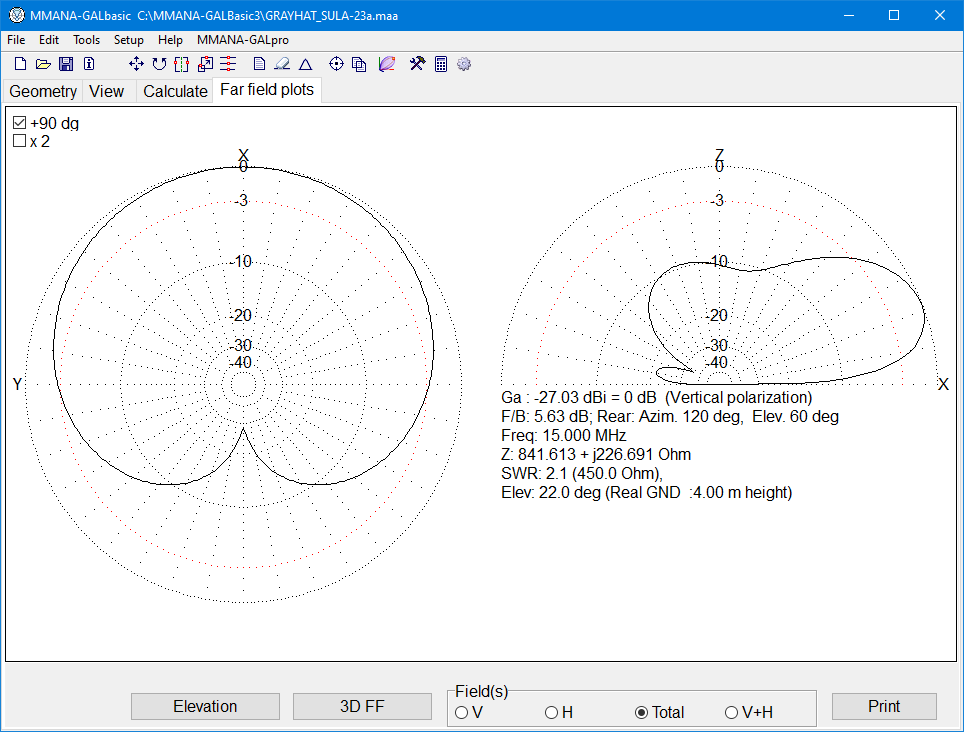

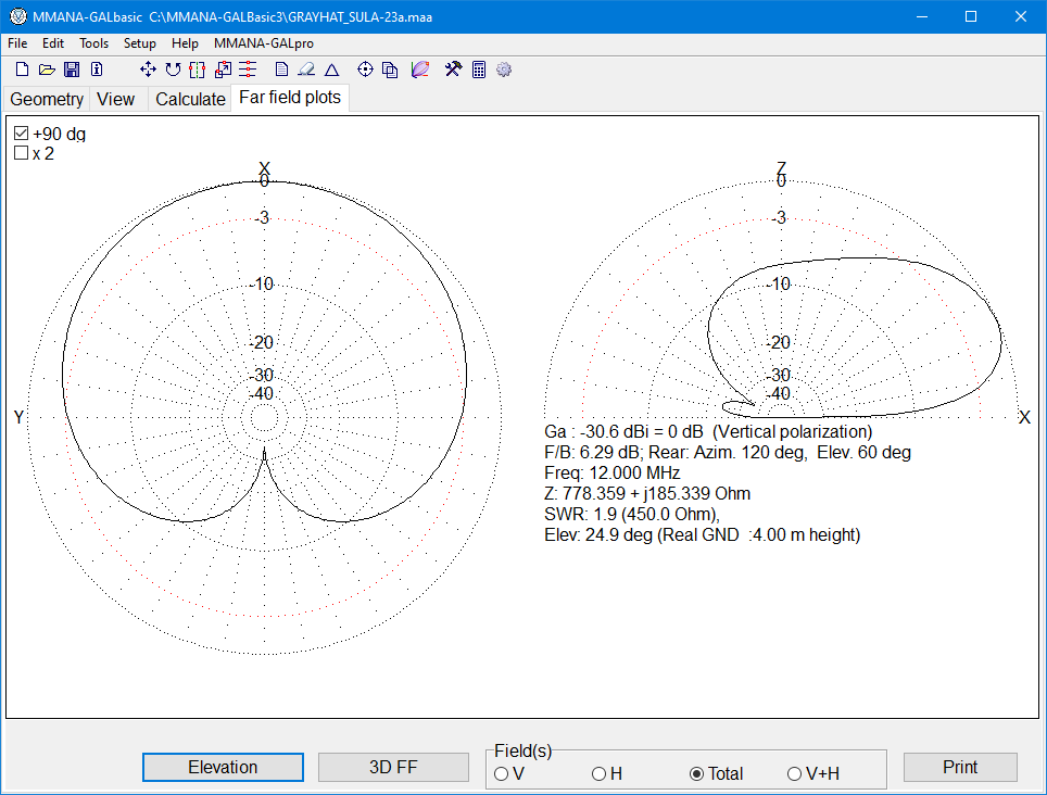

I have the free version of MMANA-GAL antenna simulation software installed on my laptop, so I put your values into the program and got the same oputput as you published,
This program is easier to use for amateurs than NEC, and can be downloaded from:
http://gal-ana.de/basicmm/download/download.php?mm=2
I also used the program to simulate the antenna with slightly larger values, 190 cm high and 30cm wide, and increasing the resstor to 680 ohms. That made the antenna even more directional with lower elevation angle on the main beam.
So I am going to change the meassures on the loft mounted antenna, and use the values given by MMANA GAL, when I get back home. If the antenna then works better than the one I use now, I will use it permanently and remove my outside antenna.
Here is the output from MMANA-GAL on 4, 12 and 15 MHz:

Happy to read that my impressions have been confirmed; while that antenna isn't "par up" with the SULA, its main advantage is the fact that it's really compact; as for the resistor value, yes, that one should be changed if the antenna size isn't the same as the one I posted, and then you may want to run a "sweep" using MMANA (I prefer NEC) to check the impedance match, see... the idea is to find a resistor value which gives acceptable match over the widest frequency range, that way the preamp (which is needed, since the antenna is small) will see a good match and offer good performance
